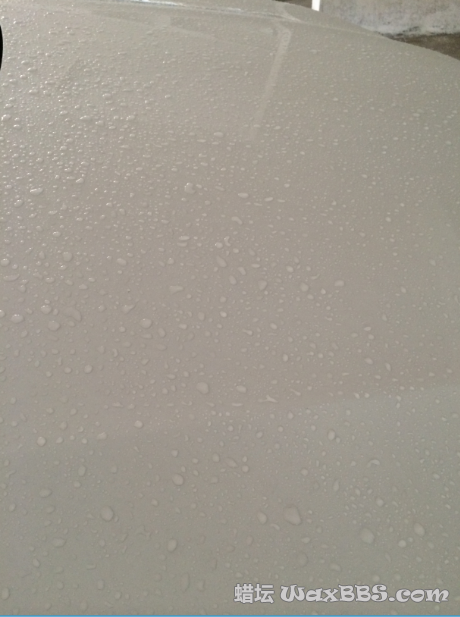

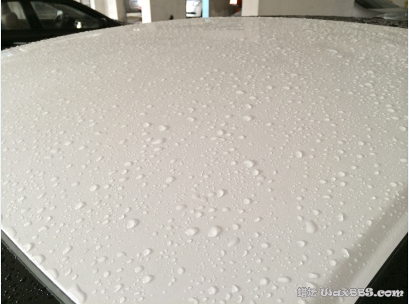

DIY作业 美光至尊蜡使用半个月后的效果
chn
2014-03-03
最近广州一个礼拜都下暴雨,前前后后经历了3次大雨的冲洗成了现在的效果,下次洗车的时候需要打蜡了吗??

tony821030
2014-01-22
感觉塌了,如果是我的话,我就打蜡了,反正蜡就是炮灰,有时间就多打勤打

清洁步骤是否施工到位?下蜡的时间是否掌握好?我们这儿也是连续大雨,半个月这样倒是不至于。

我的白天室外停铺了一个礼拜的灰尘 已经失效了

1、车身有浮尘是无法判断蜡的存在,所以要洗车完毕后才能做出判别。
2、可以说没有棕榈成分的蜡就叫封体,根据车身颜色的不同,很多中浅色的车子只要封体就好,再打棕榈蜡上去的效果反而不好,很多封体是否在的指标是泼水性而不是青蛙蛋,只要水很快流走就说明保护性还在。
3、楼主的车子水滴还有,说明蜡还在的,下次洗车就好,暂时不需要打蜡。

chn 发表于 2014-4-4 13:35
我用的是美光至尊液蜡,应该不含棕榈成分吧!?
Our most advanced, pure synthetic hydrophobic wax.
是的,所以不能用水珠的形态来判断。是否要打蜡应该用美光网站介绍的方法,洗车后用手指划过漆面,如果吱吱声就要打了。
另外有些封体是几天内有水珠,几天后就没有了,有些发文说打鲨鱼会出现这种现象,这应该不能认为保护性没有了,而是蜡的性质是如此。
How do we measure or test how well our paint is protected? All types of protection create an invisible surface layer that repels water and contaminants. This water hating or hydrophobic layer causes water droplets to either bead up on or sheet off of the paint surface, depending on the type of protectant in question. Natural carnauba wax finishes are extremely hydrophobic and tend to repel water more strongly than synthetic polymer sealants. As a result, it is usual for waxed finishes to bead up strongly in wet weather, with water droplets literally appearing to be pushed upwards off of the paint surface. In contrast, sealed finishes tend to be much slicker and less hydrophobic, meaning that water droplets don't tend to bead up as much but instead run off quickly and freely. Both of these characteristics are indicative of a high level of paint protection. In contrast, if water just sits on your car without beading or running off, then the chances are the level of protection is low.

2014-01-25
楼主,蜡还在的,只是由于表面有些微尘,造成拨水性下降。因为美光这种蜡很薄,所以很小的微尘就可以让表面不平整,而棕榈蜡分子较大,而且油性较强,所以拨水性会显得持久一点。放心,美光这种蜡至少2个月。我跟维多利亚红蜡比较过,它比红蜡还持久。
