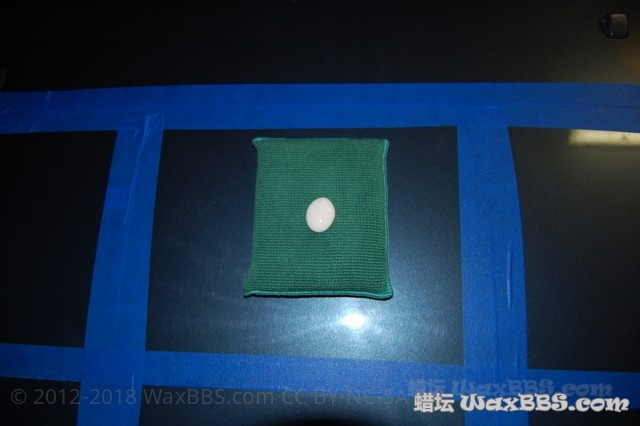

[font=微软雅黑]試驗用的產品[/font][/align][align=left]ScratchX 2.0[/align][align=left]M205 Ultra Finishing Polish[/align][align=left]Ultimate Compound[/align][align=left]SwirlX[/align][align=left]Ultimate Quik Wax (“UQW”)[/align]

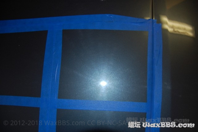

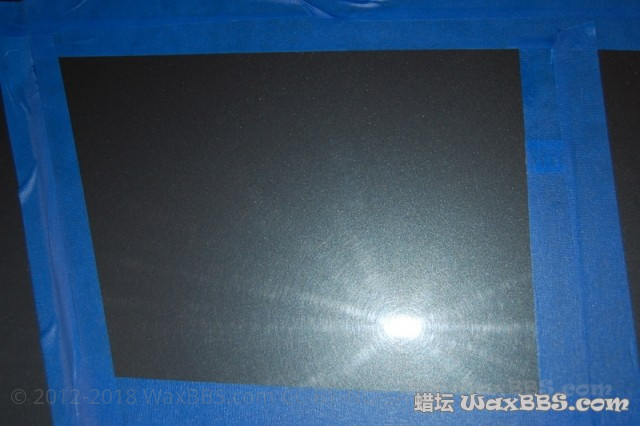

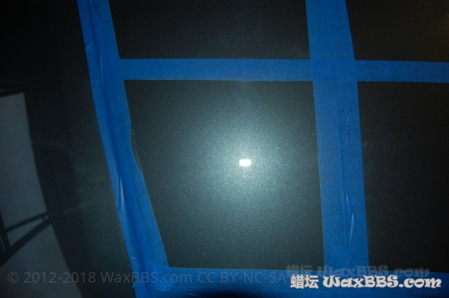

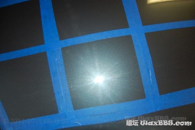

[align=left][font=微软雅黑]先將車漆表面分為六大塊,其中一塊對照組,不做任何處理[/font][/align]
[/font][/align]

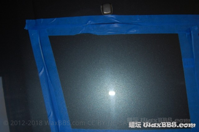

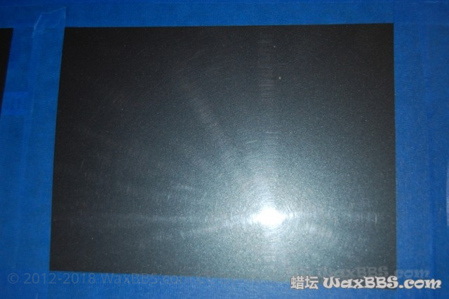

[align=left][font=微软雅黑]Block 1 (M205 Ultra Finishing Polish)[/color][/font][/align][align=left][font=微软雅黑] 20090304_0d487d540c76b9dfbb64WJbhHIdkGin4.jpg
[/font][/align][align=left][font=微软雅黑] 20090304_7c383b8c43593a1879afYL5Gx3WqhrxJ.jpg
[/font][/align][align=left][font=微软雅黑] 20090304_3dc3afe705ce9d876964pSeKAe4SXBh1.jpg
[/font][/align][align=left][font=微软雅黑] 20090304_e73bb5c2cff88bd20f3cxBHuYktxJ0sm.jpg

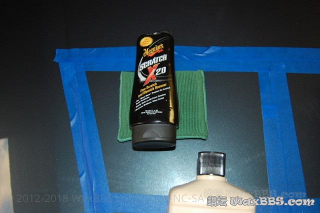

[/font][/align][align=left]Block 2 (ScratchX 2.0)[/color][/align][align=left] 20090304_83fb3dade173cb566db7wSh5Mz2M887a.jpg
[/align][align=left] 20090304_aebd3b5967d38d757422MoH2WgF8uUc6.jpg
[/align][align=left] 20090304_5fa9ac02860a548395d58GBSIs4x9X4n.jpg
[/align][align=left] 20090304_2bc87f23fb88ff9b7e04QhMXIQzt3eUJ.jpg

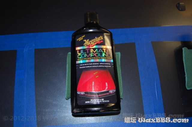

[/align][align=left]Block 3 (Ultimate Compound)[/color][/align][align=left] 20090304_8e71b95308d23ac4d94cNCrXTmD8u6uB.jpg
[/align][align=left] 20090304_1c41aa8ce4582609ef65Ku7HMH6IsNjO.jpg
[/align][align=left] 20090304_78e785857d67be0841f9KC3dGXJtw8o6.jpg
[/align][align=left] 20090304_8a33f42778634eaf3d69LVSuZqQxIXTB.jpg
[/align]

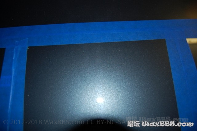

[align=left]Block 4 (SwirlX)[/color][/align][align=left] 20090304_3178b9fd1fd396271994amRAgBNLKYQl.jpg
[/align][align=left] 20090304_e73bb5c2cff88bd20f3cxBHuYktxJ0sm.jpg
[/align][align=left] 20090304_9fe6e35254b42aafa1a7lTwm0cdHbQUK.jpg
[/align][align=left] 20090304_fef48f2b545d7ea0fcf7IK40fOHuWXHH.jpg
[/align][align=left]Block 5 (UQW)[/color][/align][align=left] 20090304_31284d83dfdbc82f9f8aUx6zyWyBq6SA.jpg
[/align][align=left] 20090304_a0d7ce2403703fbf6379kAva4y013vnl.jpg
[/align][align=left] 20090304_a6c474cdb5337351c78f5vqaUzBnkl7a.jpg
[/align][align=left] 20090304_f0b905a582dfa2ce0202C9GE9vwLporl.jpg
[/align]
[align=left]Block 6 (Control spot)[/color][/align][align=left] 20090304_23a404893c7ed7d7ae8fnn9sxMwPrs7n.jpg
[/align][align=left][font=微软雅黑]總結感想[/font][/align][align=left][font=微软雅黑]當然這不是一個很嚴格標準化的測試,我只是想知道各個產品使用後的結果而以。如果你問我推薦哪一種產品?我覺得每種產品都可以,除了ScratchX 2.0。因為在我的想法中,ScratchX 2.0因該是定位在”局部處理”使用的產品。[/font][/align]
[align=left][font=微软雅黑]M205可以快速的除去螺旋紋,並留下光滑的表面。且會使漆面有較深沉的感覺,相對於上述其他幾種產品。[/font][/align]
[align=left][font=微软雅黑]SwrilX則是會產生較清澈明亮的感覺,相對於UltimateCompound與ScratchX 2.0来说。[/font][/align][align=left][font=微软雅黑]

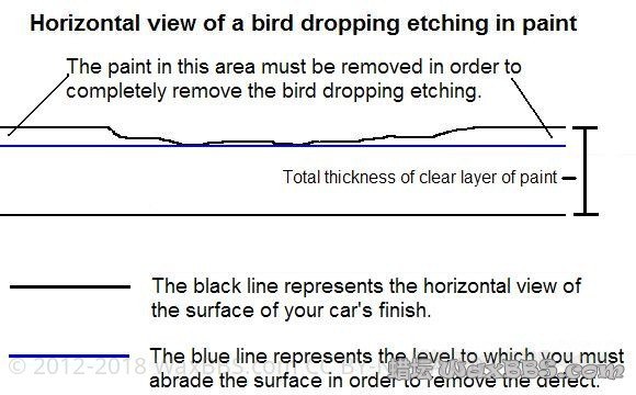

[align=left][font=微软雅黑]如果你能正確的使用,ScratchX是有效的,使用手工使用像ScratchX這樣的高科技產品來移除現代的晶油層是需要一些練習的,不像傳統的漆面或釉質漆面你可以使用舊式的研磨劑且只需少數幾次施用就可以移除刮痕(当然你的大部分的漆也被移除),高光澤的晶油層是一層薄且脆弱的表面塗層,它容易喪失光澤和容易刮傷,一旦它們失去光澤或刮傷時,可以藉著使用正确的產品、正确的技術以及謹慎與熱情讓晶油層可以恢復到有如閃耀的寶石般。[/font][/align]
[/font][/align]
[align=left][font=微软雅黑]黑線代表你車漆表面的水平示意圖[/font][/align][align=left][font=微软雅黑]藍線代表移除缺損後的水平示意圖[/font][/align]
[align=left][font=微软雅黑]黑線和藍線的中間代表你需要用手研磨掉的部分[/font][/align]

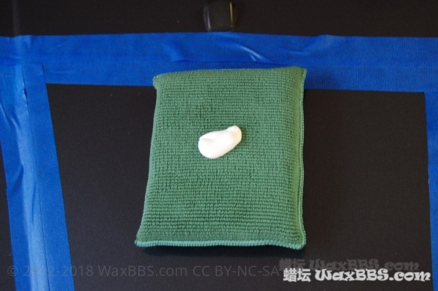

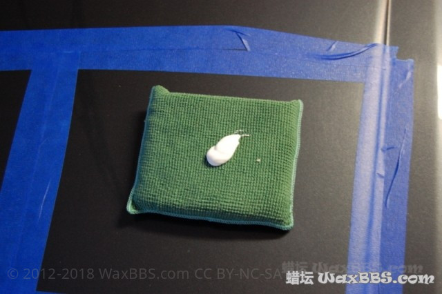

[align=left][font=微软雅黑]如何移除鳥屎蝕刻和刮痕[/font][/align][align=left][font=微软雅黑]1. 一次只在一小區域進行工作 -大約是小於6英吋x6英吋的區域[/font][/align][align=left][font=微软雅黑]2.你可以混合使用劃圓和劃直線的移動方式來進行研磨[/font][/align][align=left][font=微软雅黑]3.對著烤漆使用產品來研磨直到ScratchX看起來像是被耗盡(分解)一般。[/font][/align][align=left][font=微软雅黑]4.重新塗抹產品然後重覆上面2和3的動作並重複的塗抹研磨數次[/font][/align]
[align=left][font=微软雅黑]當我使用上述的方式來施用ScratchX時,我可以移除大約95%的鳥屎蝕刻或隨機的刮痕[/font][/align][align=left][font=微软雅黑]訣竅就是塗上產品來回擦拭直到它開始變得透明並重複施用至少一次以上[/font][/align]
[align=left][font=微软雅黑]幾個重要的注意事項[/font][/align][align=left][font=微软雅黑]1)晶油層比傳統的漆層還硬,也就是說想要從晶油層上移除缺損是更加困難的,尤其是以手來進行工作,這也說明了為什麼PC震抛機會越來越流行了[/font][/align]
[align=left][font=微软雅黑]2)ScratchX不是一種擦上抹掉的產品,它是比較近似於擦上抛光的產品,你需要一個乾淨的海綿塗抹墊,當你使用手工進行抛光時你需要多一點的熱情(因為會推到手快斷了)。[/font]

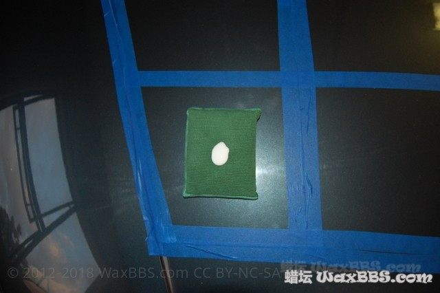

楼主你这个帖子太好了,刚好是我遇到的问题。。

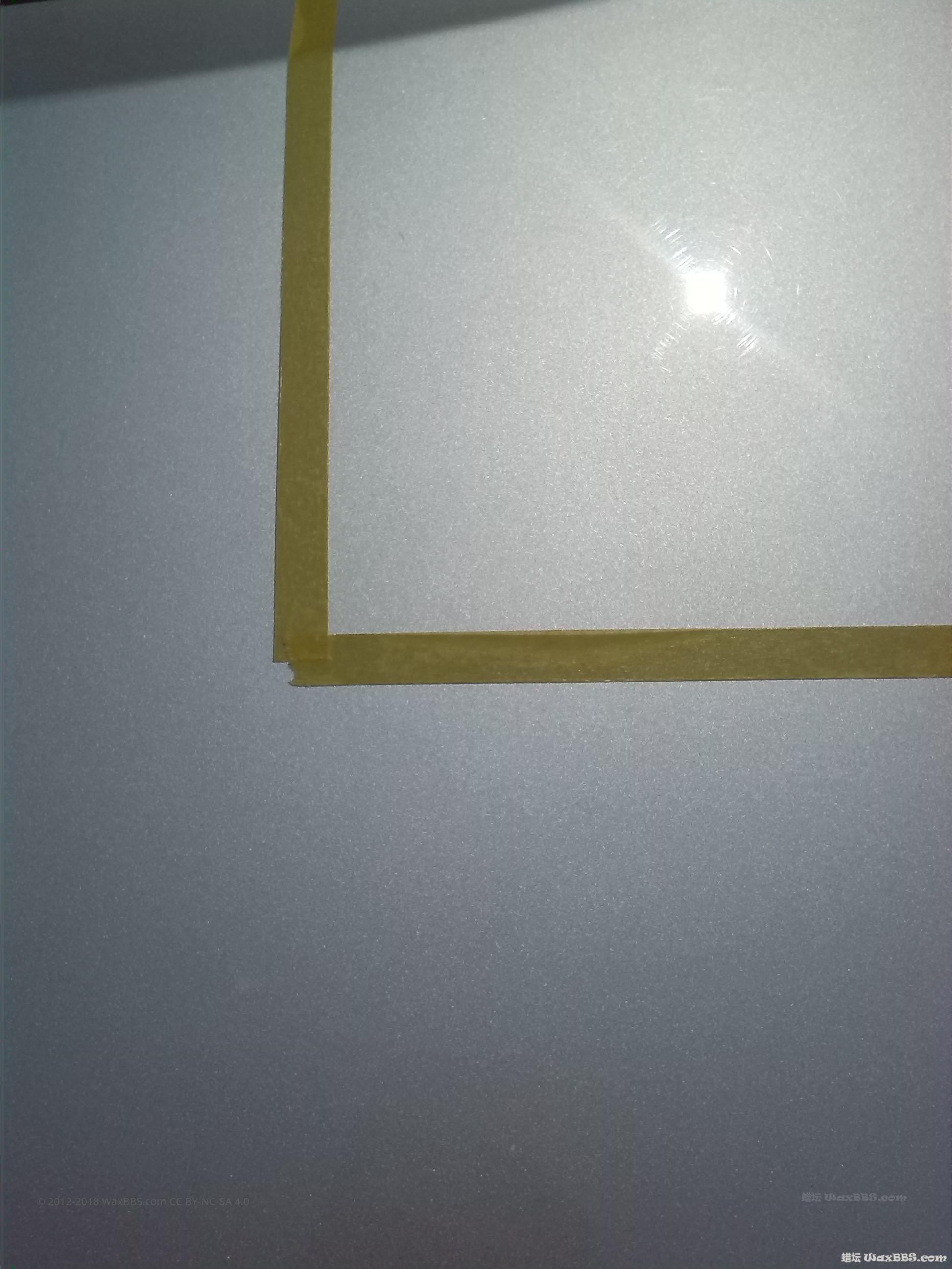

我最近用Ultimate Compound,准备去机头盖的太阳纹,但无论咋摩都摩不去。。很奇怪
产品:Ultimate Compound
工具:干净的美光海绵
之前我用别的产品去划痕感觉自己虽然只是车主,但去划痕还是有一定经验的呀。
这次用这个Ultimate Compound,只是去太阳纹,遇到问题很费解,尝试过很多摩的办法,还是前后去太阳纹不明显,
不知道是手法问题还是什么问题?求大神指导呀。请见下图,这是用Ultimate Compound之后的图,和没用之前没啥两样。。打磨了几次了还是这样。。
    690.2 KB · 浏览: 587

等坛里大神回答你的问题,我是新手{:240:},不过有说法是手动不可能全部去除太阳纹,沃夫冈的去纹剂里明确写明去除太阳纹需要机器。
