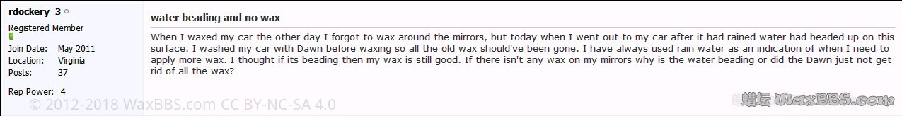

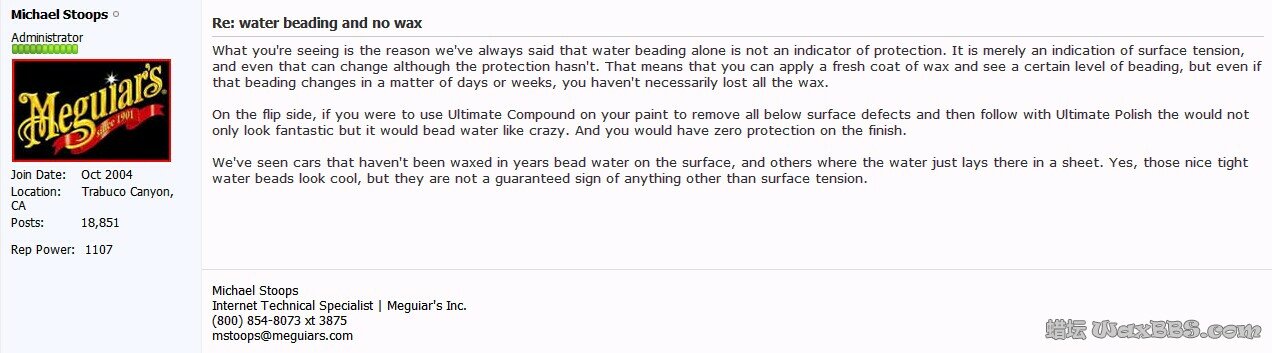

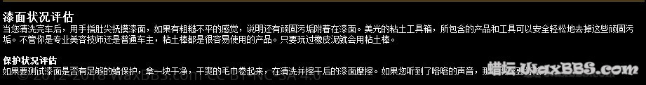

主题不同,另外开这个贴吧:
美光官网的方法:
图片要点击放大才方便阅读。{:69:}

Another quick test is performed after your car is washed and dried thoroughly, Fold a 100 percent cotton terrycloth towel until it's hand-sized and thick. Apply firm pressure to the car's surface and twist the cloth back and forth in a clockwise and counter clockwise direction. If you hear a squealing noise, then you're due for a wax job.
美光官网之外也看到了这种方法
当然,水珠也可以作为一个参考标准,只不过不能作为唯一绝对标准。

水珠判断蜡层保护性的方法不单在这里有讨论,洋人早已争论过很多,这个贴的重点也不在推那几下,而在于美光技术砖家回帖里说的那些内容,能纠正我们对水珠的错误看法。
