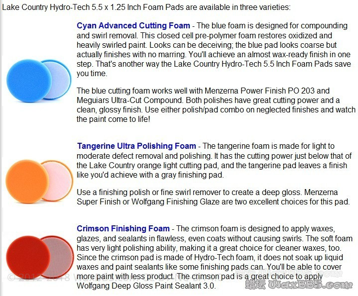

89083134 发表于 2013-11-29 13:27
Lake Country Hydro Tech Crimson Ultra Fine Finishing Pad
既然是FINISH,而且这个系列总共也就蓝橙 ...
亲,我查到了……“has very light polishing ability”
