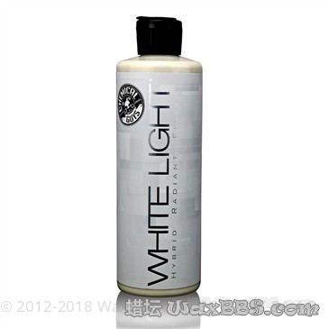

我的是白车,指腹测试等了40分钟还是不会黑亮..
白色的车现在可以选择白光whitelight~~
CG的官网相关信息:
Gloss enhancer with brilliant shine
Creates a wet, bright finish
Perfect for white and light colors
Safe for all color finishes
Easily applied by hand or machine
Often used in conjunction with Hybrid V7 and White Wax
Perfect for creating a show-winning shine
Also available in 4 ounce size
